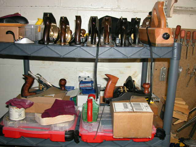

PostPosted: Sat Mar 11, 2006 1:40 am
Posts: 639
I think there are about 10-12 more not in this picture. See what I mean about guilt? I'm just as awful about chisels
PostPosted: Sat Mar 11, 2006 2:16 am
